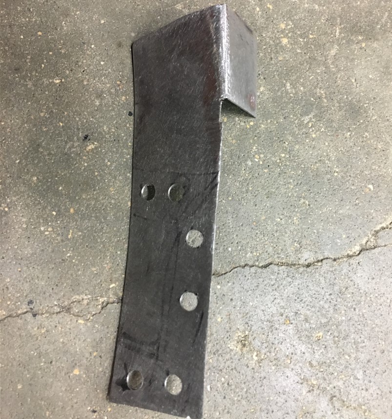

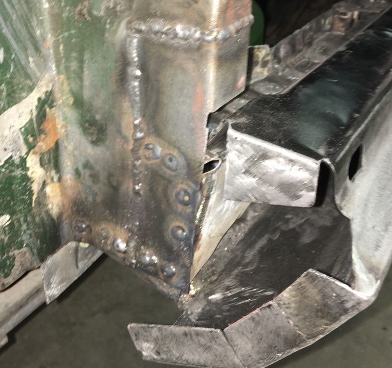

RH Trunk Drop
So the trunk drop looks terrible before cleaning up but really only the bottom flange was really rusted. I had an NOS piece to use but I was quite certain I could save this with some creative fitting and grinding. At worst I would waste some time trying. The NOS drops were dear $$... and I do have other Novas.
Attachment 212205
To save the beads, my plan was to weld in a replacement piece and grind out the backside where it overlapped the beads
Attachment 212206
Attachment 212207
Replacement flanges were made, copied from the NOS originals
Attachment 212208

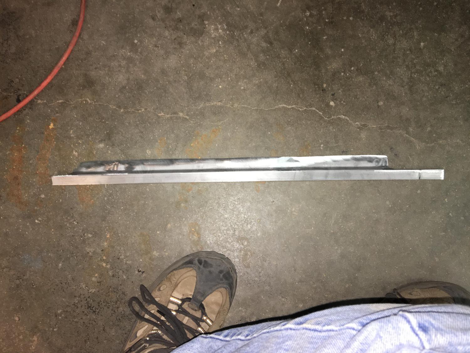

L78_Nova 01-27-2022 02:53 AM
1970 L-78 Nova Restoration; Saga of The Green Bastard
3 Attachment(s)
Rough fit
Attachment 212209
Attachment 212210
Tacked in
The plan is to weld in solid from this side then grind open the formed beads from the underside (exhaust pipe side)
Attachment 212211

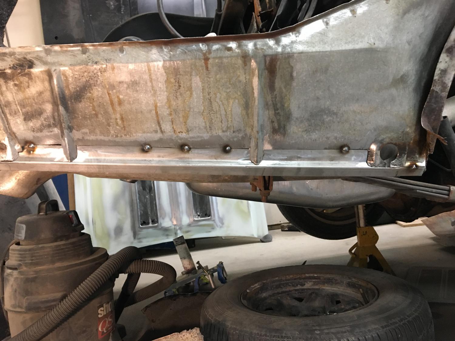

L78_Nova 01-27-2022 04:31 PM
1 Attachment(s)
I cheated and Fast Forwarded to an underside shot so you can see how the trunk drop turned out from underneath. This side was finished up on the rotisserie.
Attachment 212245
