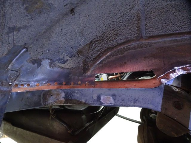

Anyway, I was stalled out on this issue with the right inner wheel house to trunk floor mis-match. I've run into this on every floor I've done, but not this much of a gap. I could pull the inner to the floor, but it was barely touching, so I found the scrap of left inner house I had kept and it had the right curvature and incline to match the patch I needed nearly perfectly.
https://www.yenko.net/forum/cache.ph...2FDSC08532.JPG
https://www.yenko.net/forum/cache.ph...2FDSC08533.JPG
https://www.yenko.net/forum/cache.ph...2FDSC08534.JPG
https://www.yenko.net/forum/cache.ph...2FDSC08535.JPG
https://www.yenko.net/forum/cache.ph...2FDSC08536.JPG
I started the welding in the corner and was able to clamp the 3 pieces pretty tight underneath, but the top of the patch wanted to stick out away from the house. I didn't want to use a bunch of drill screws to hold it and then have to weld them up, so after welding 3-4 plug holes I quickly reached in while the metal was hot and tapped the patch flat. Dang, I love it when an idea works.
