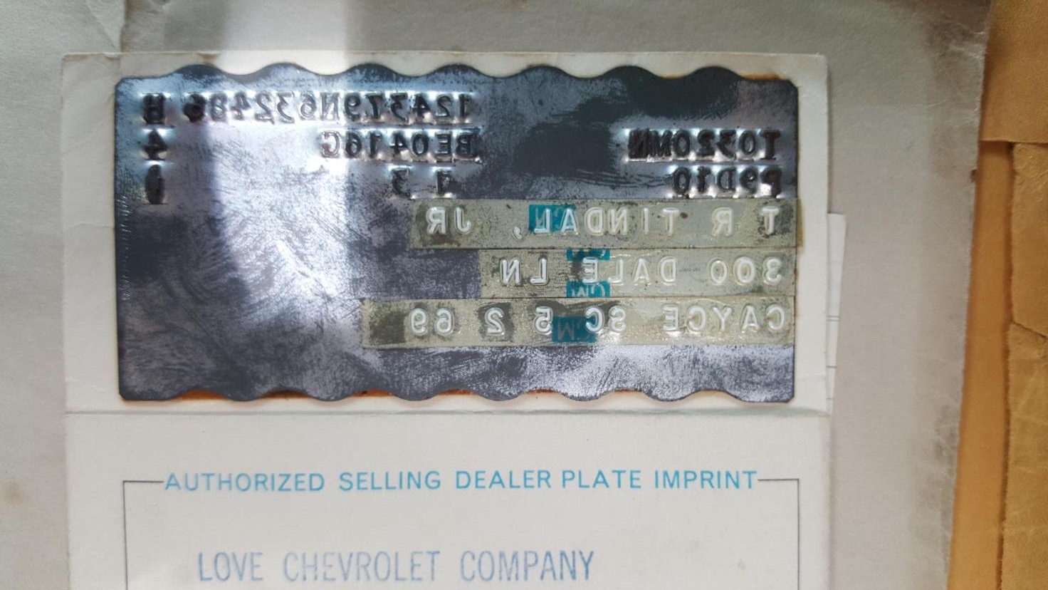

After looking at it in its "as found" condition, I certainly believe what you are saying Matt. The "BE" looked good to me. How did you determine the assembly date?
Fast67VelleN2O 04-23-2017 09:06 PM
The assembly date on the rear end housing? 0416G2. April 16th. I don't know the assembly date of the car.
bergy 04-23-2017 10:46 PM
I was asking how you figured out that 0416G2 was the actual assembly date. It looked like that part of the stamp was gone prior to the repairs.
neresto 04-23-2017 11:06 PM
There was nothing welded over the stamping, it's just rusty marks from a U bolt. It was perfectly fine under the paint.
bergy 04-24-2017 01:27 AM
I see it now - thanks

Fast67VelleN2O 10-02-2017 05:47 PM
Just to recap.. the negative comments about my BE rear in this thread lost me my sale, so thanks to that for the people who have no clue when it comes to rare parts like this. It was just recently brought to my attention by another member here that I have the same exact rear as another COPO currently listed for sale. Just a heads up to all the naysayers... here is a DOCUMENTED COPO that has the same exact rear end date code and assembly stamping.
https://www.yenko.net/forum/showthread.php?t=144521
https://www.yenko.net/forum/attachmen...1&d=1505774913
https://www.yenko.net/forum/attachmen...1&d=1506887780
HawkX66 10-04-2017 01:23 PM
If my comments attributed to your loss of sale, I truly apologize. I just read back through the thread and only see a reasonable discussion though questioning something that didn't look right. Uneducated on the specific subject as the opinions might have been, I stated that it was just my opinion based on what I was seeing in the pic. I'm sure my words aren't going to fix anything, but I do apologize if I screwed something up for you.
