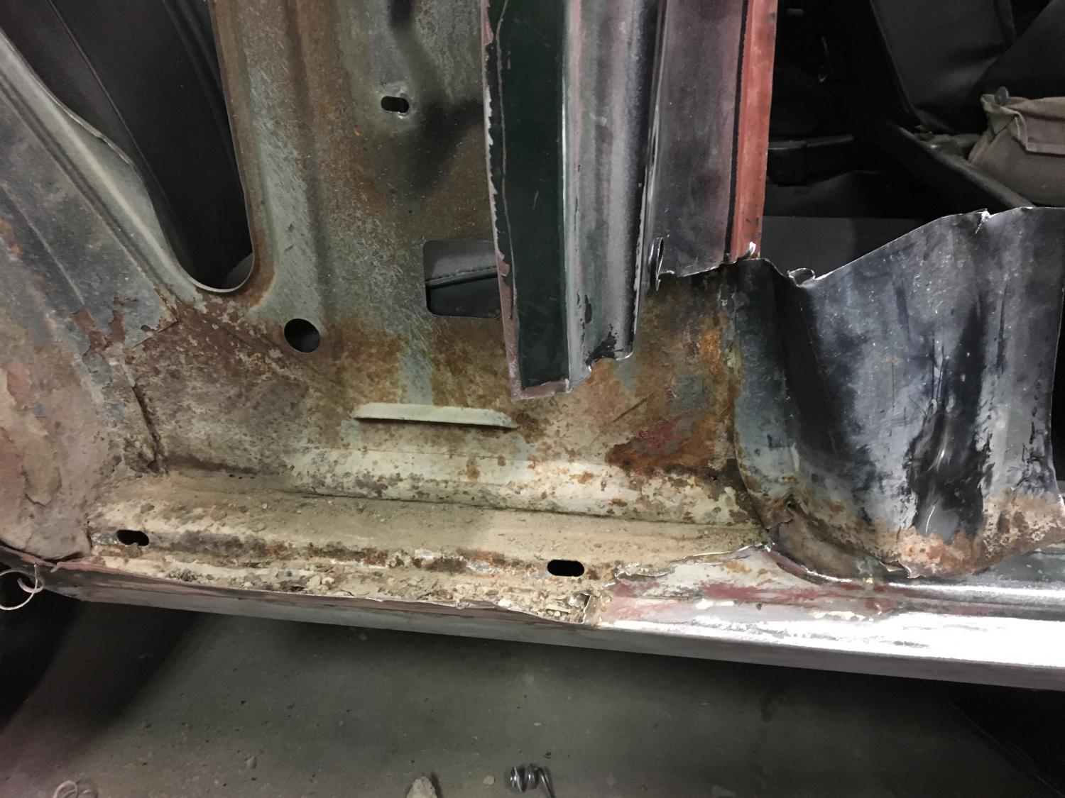

Continued removal of the quarter
Attachment 212012
Attachment 212015
Attachment 212013
Close up of the rusted area. Top of rocker is badly pitted.
Attachment 212014

With the panel off the quarter window post will be easy to correct.
Attachment 212060

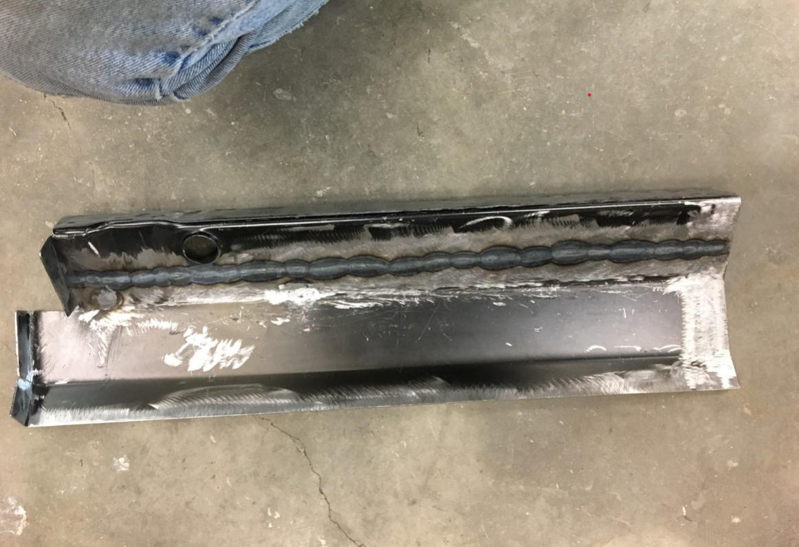

I fabbed a backer with plug welds to provide some extra strength to the rocker joint
Attachment 212180
Attachment 212181
Hard to see in the photo but a taught string line along the corner allowed for an easy alignment visual when tacking in place.
Attachment 212182

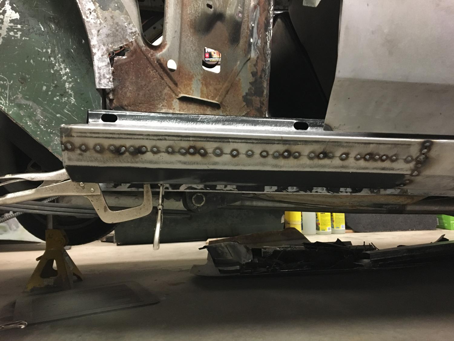

Lower half of replacement piece. I made a clamshell die to replicate spot weld dimples along the lower body flange. I then drilled holes in between the dimples for plug welding
Attachment 212188
All tacked in place
Attachment 212189
