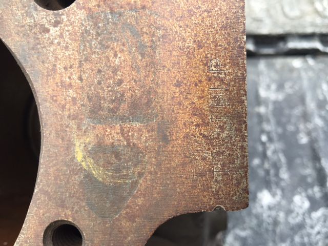

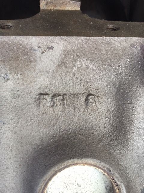

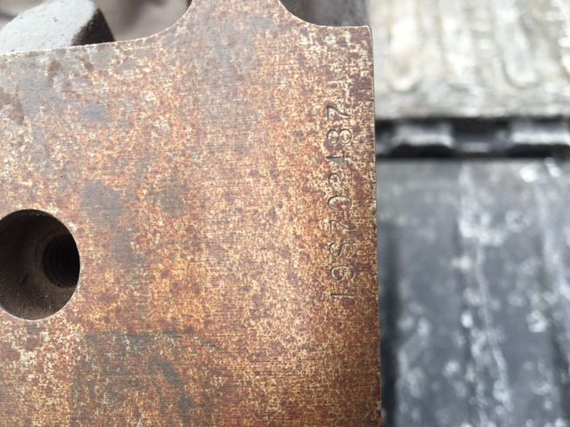

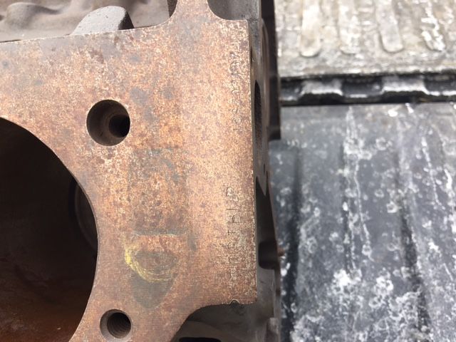

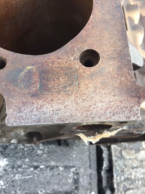

Here are some more pictures. The block is now in my possession and will be getting magnafluxed and cleaned. The stamp reads T09I6LP and the vin read 19S702487 The date is F 14 8 June 14th 1968

bergy 02-12-2016 03:29 PM
Re: Whats it Worth
Broach marks should be perfectly parallel and deep ones should be fairly continuous. I'm saying re-stamp. JMHO
black69 02-12-2016 04:59 PM
Re: Whats it Worth
Its hard to tell, without WD40 cleaning with a rag. I would still have Al G look at it.

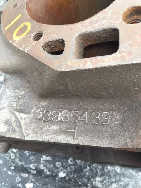

Caseys69 02-12-2016 08:39 PM
Re: Whats it Worth
After using WD40 and a rag
