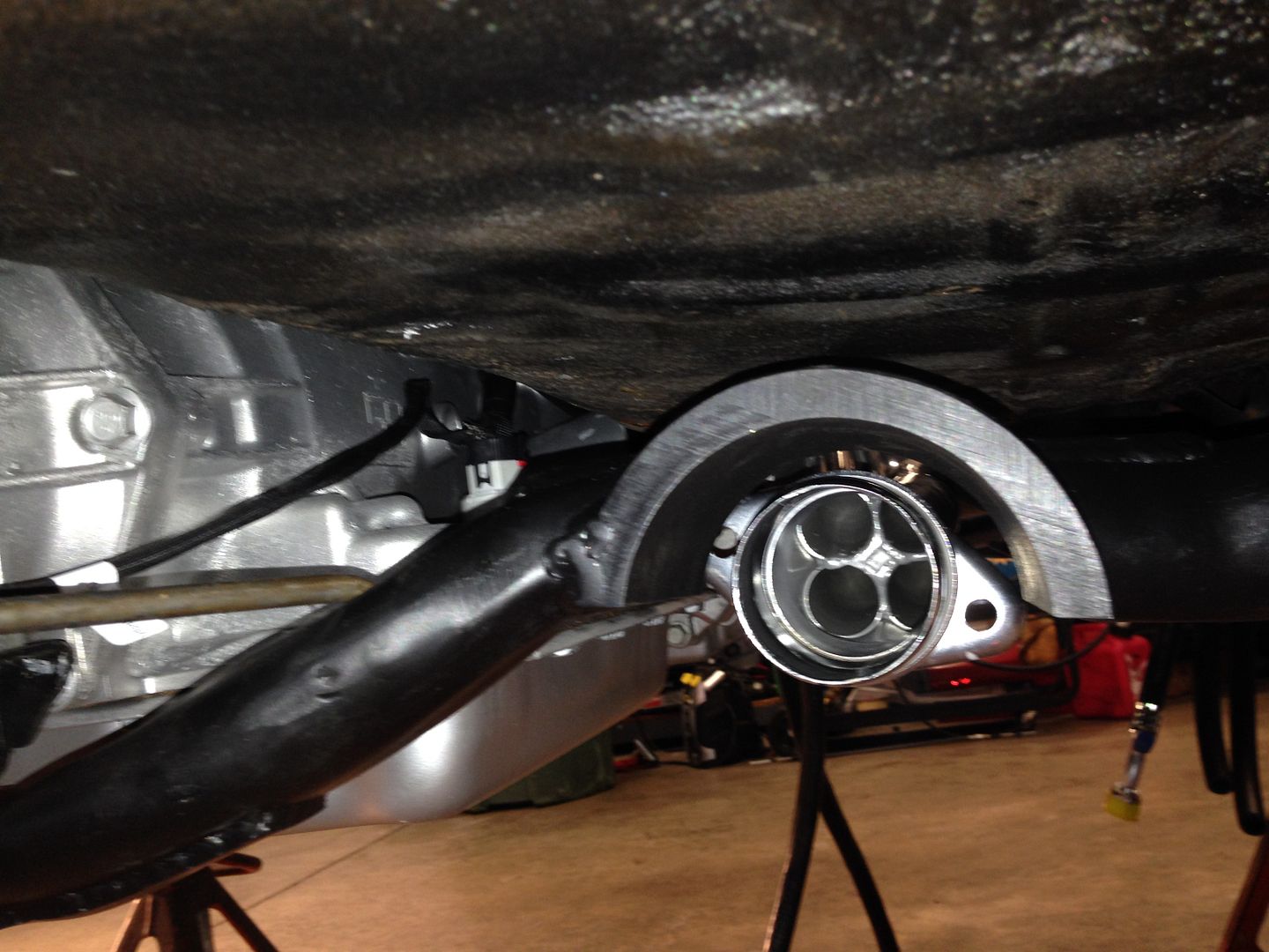

I got the driver side Flowmaster header installed.........It wasn't as simple as the passenger side........Seems Flowmaster forgot about the lower control arm mounting bracket on the Drivers side.........Had to remove a good sized chunk of the bracket to clear the pipe......structurally is won't matter.....But!!!.......for what they charge for them , they should fit without any mod's.......and .....my engine is about 3/8 higher than using stock adaptor plates.......So.....it would have been much worse with the header if the engine was lower.......I also have to rework the trans crossmember as the collectors run right into it.........

After getting the Headers installed the other day.......another little issue popped up........LOL.......The collectors went right thru the trans crossmember..........Always something...........As long as I had to modify it .....I added some reinforcement plates to the areas welded previously.........It is now in to stay....(I hope).......Also I put the coil pac's back on and realized the factory spark plug boots aren't going to work.....so I ordered some new ones........always something......
