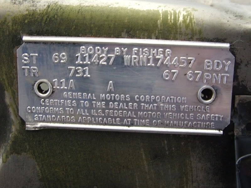

You mean like this zink chromate on Gardy's Nova ?
Also note the absence of caulk in the ribbet holes. It looks like the only paint under this tag is the brushed on Zink Chromate.
http://i18.photobucket.com/albums/b1...9NovaSS174.jpg
