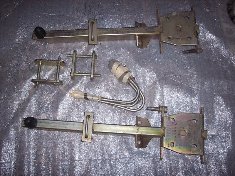

BillD 04-27-2008 09:09 PM
Re: Vintage Traction Bars
Bill - It appears you have 2 different driver side bars. The shock mount would be on the other side of the bar for a passenger side application.
[/ QUOTE ] Glen, I have another set of these and they also have the same shock mount locations, however the second set is of equal length.
Salvatore 04-27-2008 10:20 PM
Was one bar cut down? Also some bars where for mono leaf and multi leaf.
BillD 04-28-2008 02:33 AM
Sam, It doesn't look like one was cut down, also they are weathered the same so I think they are a matched set. However, this stuff is close to 40 years old so who knows. I just want to figure out if these are supposed to be this way before I take 2 inches off the longer. These are very hard to find so I don't want to mess them up.

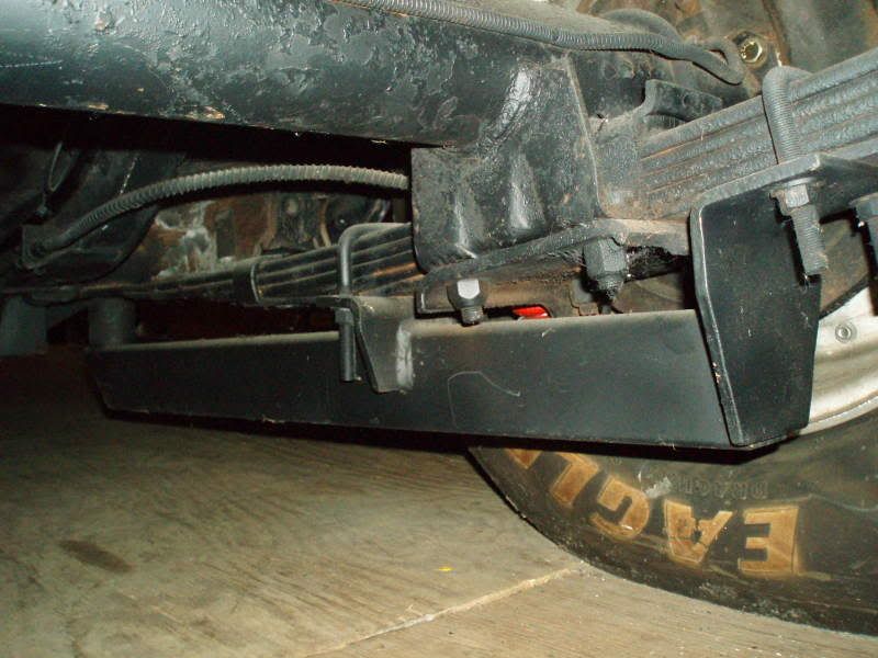

396L35 04-28-2008 03:04 AM
Here are a few pictures of mine still on my car.
http://i7.photobucket.com/albums/y29...20Car/RC24.jpg
http://i7.photobucket.com/albums/y29...20Car/RC25.jpg

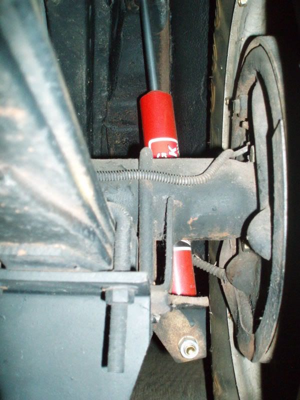

Dog427435 04-28-2008 03:58 AM
Bill - Here are a couple shots of the Lakewood bars on my car. These work very well, I'm running 10 sec
times with a 28 X 10 tire.
As you can see the shock mounts on the outside of the frame rail, so the shock mount bracket also needs
to be on the outside.
I don't know the length of your bars - mine are 32" - if I were to cut mine down that would place the snubber
in the wrong location.
(Don't mind the dirt and cobwebs it's been a long winter!)
Hope this helps - Glenn

70-SS/RS-L78 05-02-2008 05:30 AM
Hear is a set with J bolts and front spring clamps to preload the bars, I am about to
to eBay these, I think they are Lakewood’s. I had them on my Camaro and “They work Great”
http://i25.photobucket.com/albums/c5.../56VERT002.jpg
