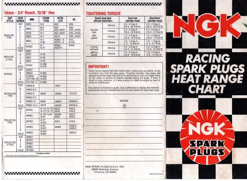

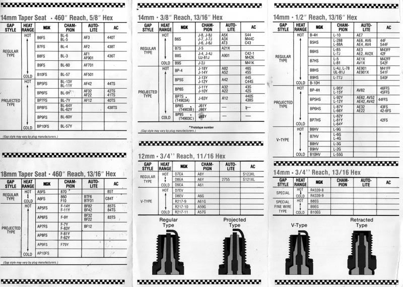

The pics you posted show two different types of plugs, one is a projected nose, the other is not. If you don't want a projected nose, and can't find a NGK "normal" cross reference, go to a racing plug if you can find the right heat range. I use a cold NGK racing plug in my L78, and they work fine. They are a .460 reach.
If you don't want the projected tip, you could go with a YR5 / 7052 (same as UR plug except w/ non-projected tip)...
