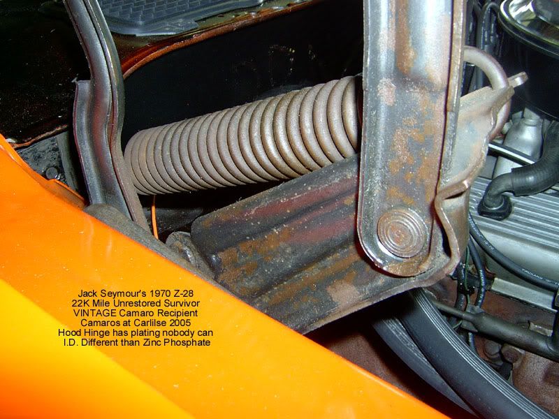

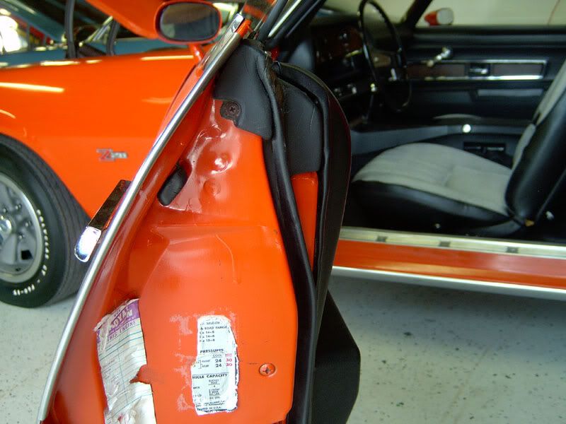

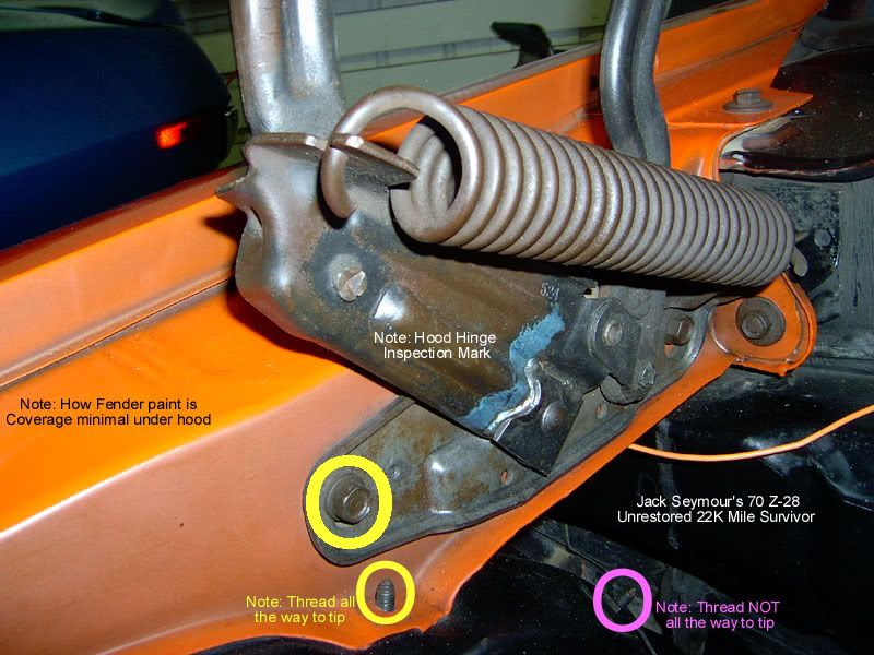

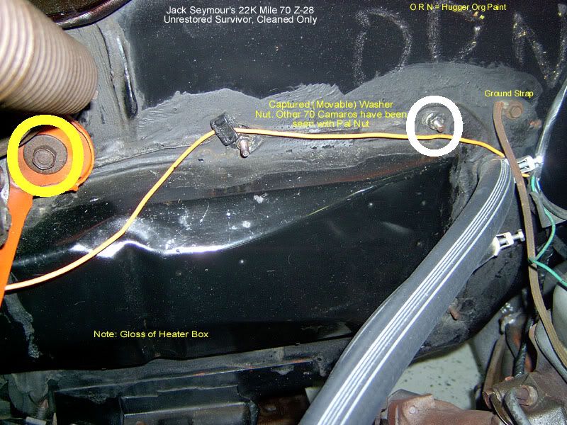

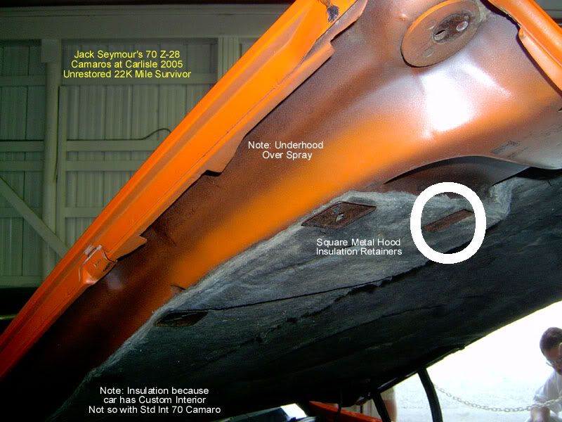

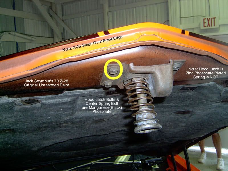

Boeshield can be bought now at SEARS Tool Depts. I also suggest looking at Boaters Discount World. You could also do a GOOGLE search. I have seen a wide range of prices, so look around.
Jack Seymour is a fellow Carlisle 2nd Gen LEGENDS judge, and the owner of the 70 H.O. Z-28 Survivor refered to above.
Jack has photo documented his 70 UNMOLESTED SURVIVOR better than any other 70 I know of. Not sure what to use for search terms on this site or over at www.nastyz28.com, but MANY pics have been posted.......
I will post a few below and hopefully Jack will chime in.

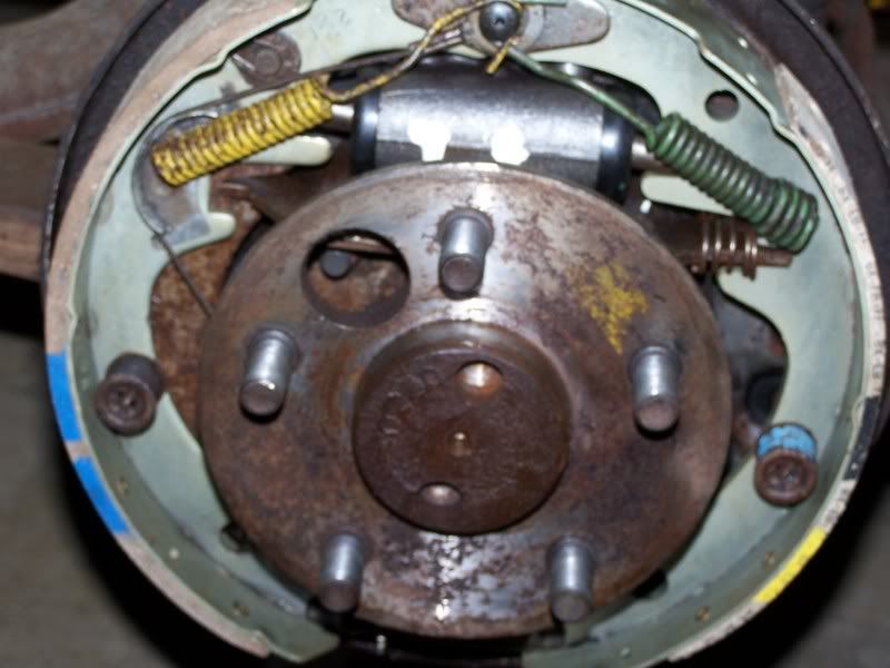

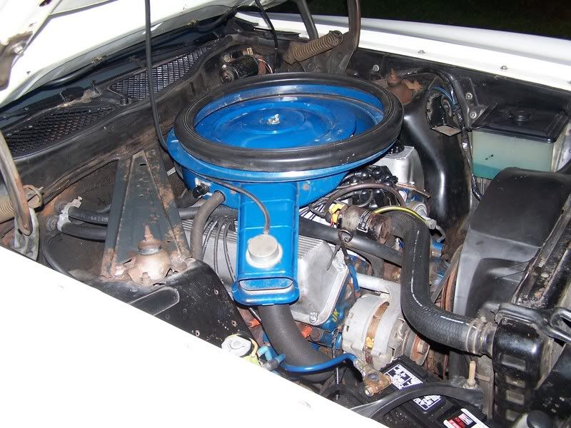

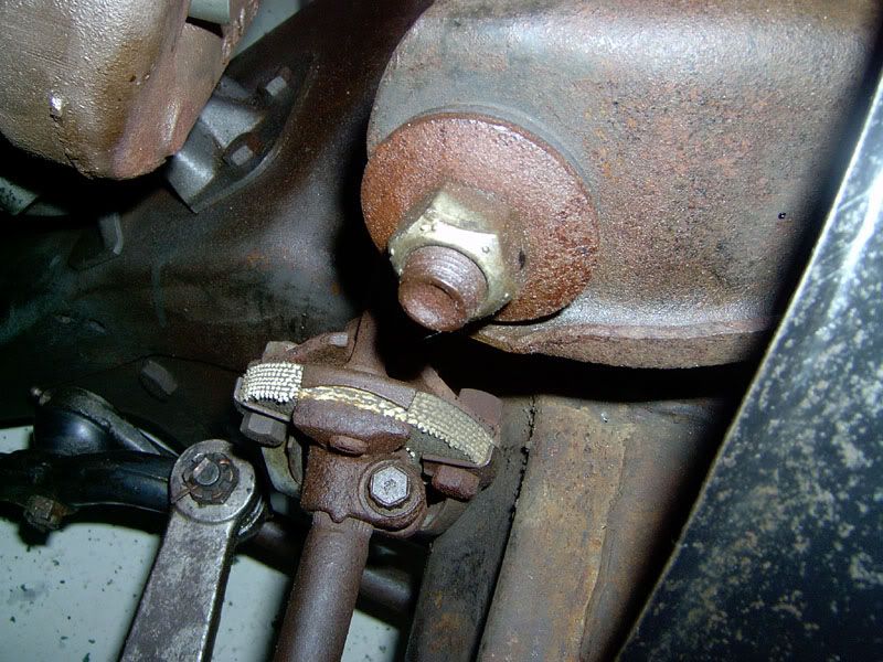

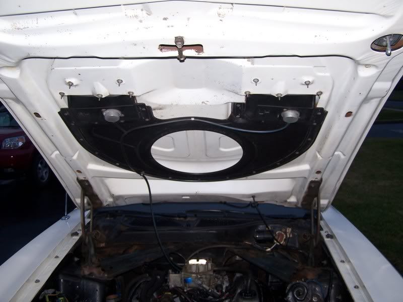

Boeshield is awesome stuff. Here are some of the results from my old survivor Boss 351. Nothing painted just cleaned and treated.

Nice pictures Chuck https://www.yenko.net/ubbthreads/imag...iggthumpup.gif

Chuck...I gotta say thanks for the text and highlighting in the pics you posted. You have posted similar pics in the past and it really is nice to have someone taking the time to record this kind of stuff for future reference.

I will second that. Chuck has spent hundreds of hours doing this and seldom gets enough credit for his efforts. I know that I use his photos as often as I can and he is doing what I have always wanted to do but never took the time. Thanks Chuck!! https://www.yenko.net/ubbthreads/imag...ns/worship.gif

The best part is the photo editing - otherwise I wouldn't know all of the details that made the photo worth taking in the first place, ie; a pointed bolt w/out threads to the end vs. one that is. Cool stuff!

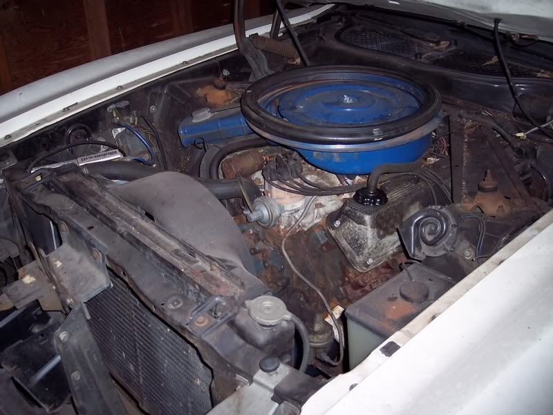

I thought I posted a before cleaning and Boeshield pic.
Before
http://img.photobucket.com/albums/v6...1/100_0335.jpg
