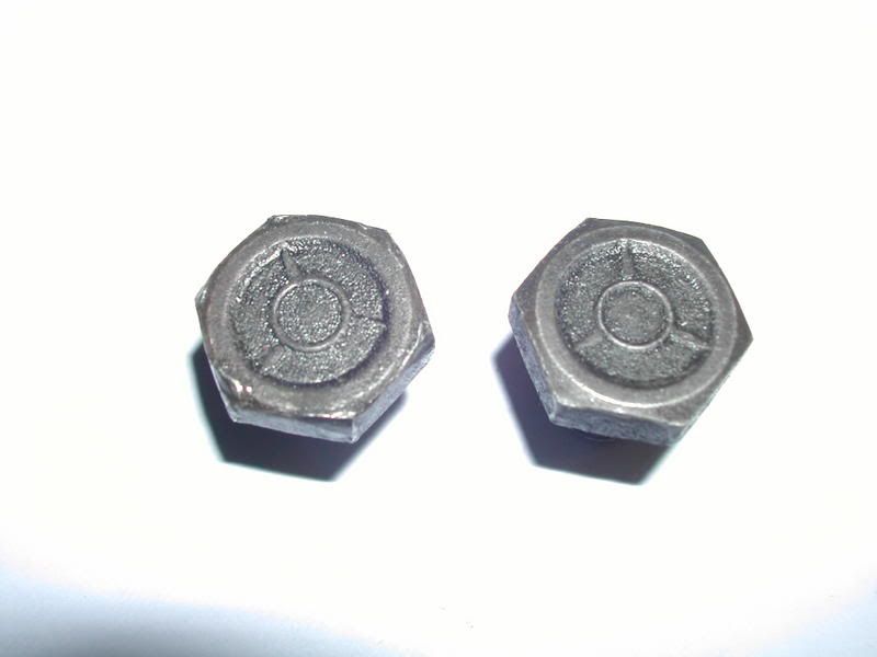

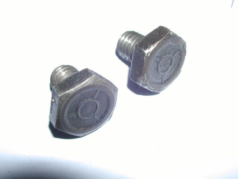

Hotrodpaul 01-26-2007 07:59 AM
Re: Correct bolts/nuts used on SHP converters
Here are two of the six converter bolts in my 70 Z-28:
http://i3.photobucket.com/albums/y86...6/DSCN5276.jpg
http://i3.photobucket.com/albums/y86...6/DSCN5277.jpg
http://i3.photobucket.com/albums/y86...6/DSCN5278.jpg
Some Dimensions:
Thd Length = 1/2"
Thd Spec = 3/8 - 16UNC
Head Thickness = .235"
Hex = 11/16"
Hope this helps.
Paul
nuch_ss396 01-26-2007 08:20 AM
Paul,
That's what I needed to see. Thanks a ton ! Now, pull the
other 4 bolts out and send them to me so I can see how well
they look together on my converter. https://www.yenko.net/ubbthreads/imag...ns/naughty.gif
Nuch
