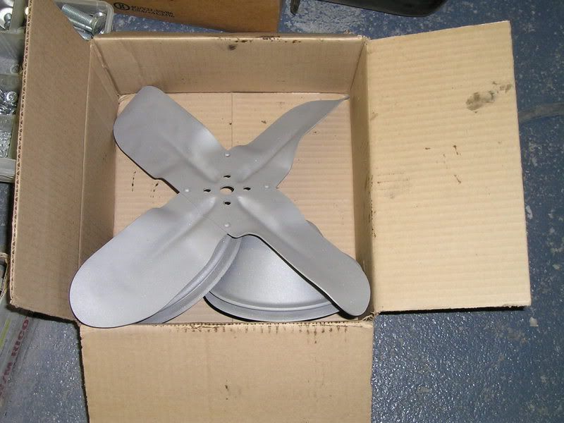

Sand blasting:Absolute bear metal.
http://img.photobucket.com/albums/v4.../12-22-062.jpg

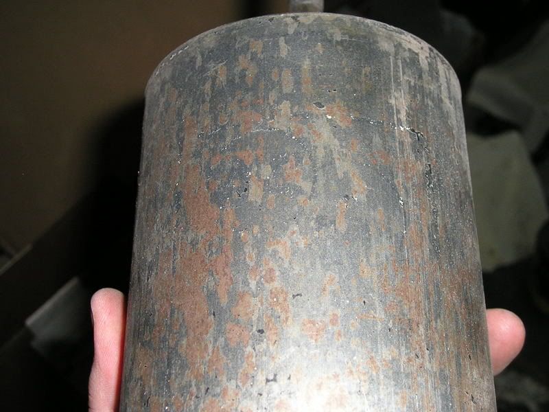

Media Blasting: You can still see the outline of the original AC Delco ink stamp on this oil canister from a '58 Fuelie Vette.
http://img.photobucket.com/albums/v4.../12-22-066.jpg
Hope this helps.
