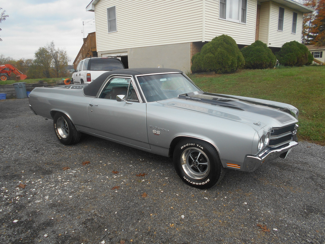

I am the opposite. I have a 70 Elky,454 factory air. When I bought it, it sat way to low. Ordered Elgin springs, supposed for my application, barely raised it an 1 1/2. It is still to low for my taste, I like the front end to sit higher. Not a gasser look, but a little higher than the norm.
What are the springs and #'s you used to get the higher look?
First pic is with springs when I got it, second after Elgin installed. Has repro 15" wheels. It is now 27" from the ground to the wheel well lip.
https://i.postimg.cc/nc9V96MX/DSCN0504.jpg
https://i.postimg.cc/bYWpP3Lp/DSCN0517.jpg
