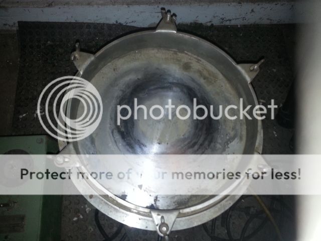

heres my laboratory vibrator thingy..i used to bungee the cheap plastic barrel on it..it gave me 2 options
http://i396.photobucket.com/albums/p...psreg6rcse.jpg
http://i396.photobucket.com/albums/p...psraghez4i.jpg
http://i396.photobucket.com/albums/p...psaihmowbh.jpg
http://i396.photobucket.com/albums/p...pshedawtkt.jpg
im trying to figure out what to put this in..
