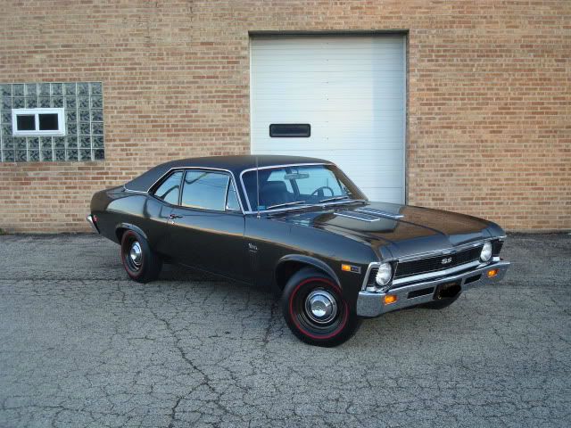

Nice Jeff! Do tell!!!

survivors make it that much better! great looking car!

Cool stuff Jeff!!
