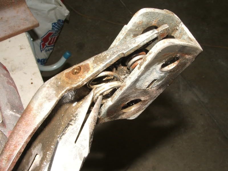

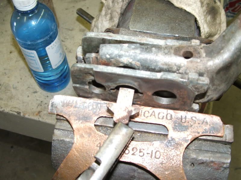

m22mike 06-29-2009 10:40 PM
Re: Rebuilding a Hurst Shifter
Darren sent me a PM and asked how to take this part of the shifter apart. I will answere here so "Buckeye Boy" Sam don't ax the same question later, pay attention Sam... https://www.yenko.net/ubbthreads/imag...lins/smirk.gif
http://i18.photobucket.com/albums/b1...e/DSCF6978.jpg
Drive out both roll pins ( to be replaced latter )
http://i18.photobucket.com/albums/b1...e/DSCF8018.jpg
Then twist the shifter and pull out the large diameter spring.
http://i18.photobucket.com/albums/b1...e/DSCF8020.jpg
Pull this gizmo stright out
http://i18.photobucket.com/albums/b1...e/DSCF8021.jpg
Once that flat "T" is out, again twist the lever some and pull the small spring out, and watch for the washer. This washer is on the inside.
http://i18.photobucket.com/albums/b1...e/DSCF8025.jpg
Good idea to take some notes and/or alot of pictures for reassembly. Pay attention to the position the shifter lever in relation to that "U" shaped spring housing... it can go together backwords...I did it... https://www.yenko.net/ubbthreads/imag...ins/tongue.gif even with the pictures.
Mike https://www.yenko.net/ubbthreads/imag...iggthumpup.gif
